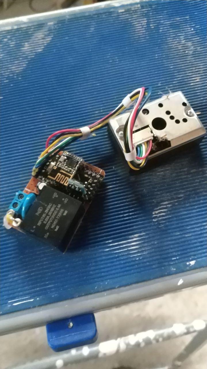

[attachment=0]photo_2020-06-28_13-15-03.jpg[/attachment]
